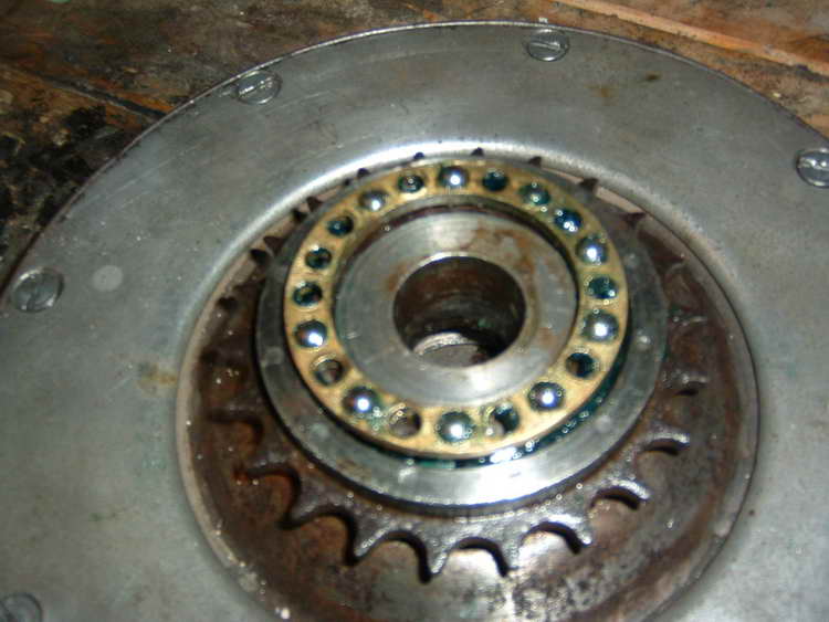

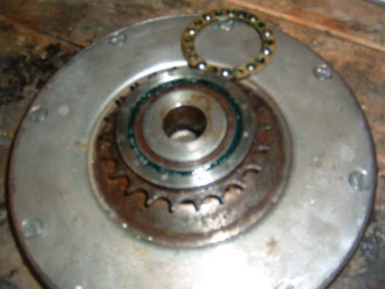

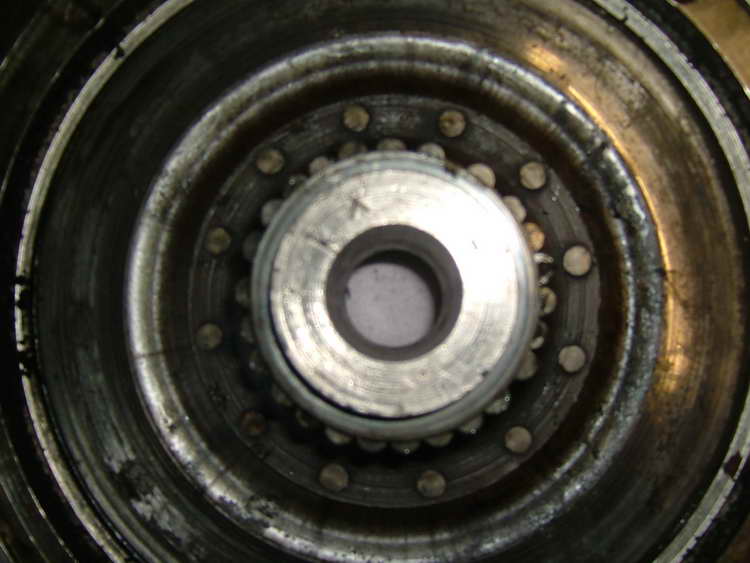

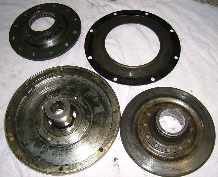

Hi All,Well David H arrived from Melbourne with his wife Nette and so we set to the Ew to get it started everything was going fine till we discovered the clutch was slipping and the flywheel wasn't responding to us kicking the engine over the sprocket was slipping and therefore the flywheel wasn't turning.So we stripped down the flywheel and we maintain the boss of the flywheel had been ground down at some stage and was sitting flush.We looked at photos of David Barkshires clutch assembly and noted his flywheel boss sat proud by how much we would like to know.Also we think there may be a part missing does the thrust race have a retaining washer if so a photo or something would be appreciated.What we thought was was needed is the flywheel  to be re machined in some way so the centre boss sits proud.If all this was achieved  the clutch could ??????? work properly.
We would like some input Dave goes home on Sunday god what a help this guy has been.Tomorrow we are going to try to set up the bike so there is no clutch but at least get the engine going and that my friends will be a plus Have attached photos to try to show what we are on about.
Regards Bazza and David H

Barry,
          If you still have the flywheel off the engine, check that the clutch plate is being gripped by the pressure of the clutch springs - if it is , the clutch/flywheel is probably assembled correctly. Then refit the flywheel and check to see if there is any free movement of the operating cam with the cable disconnected. If there is no free play, the flywheel is probably going too far onto the crankshaft (probably due to previous attempts to restore the taper) and some reworking of the thrust race may be necessary to gain some free play (or, if there is enough clearance inside the flywheel, a thicker than standard clutch lining could be fitted - this would give more more free play). If there is free play but the cable wont reach the operating arm, a new, longer inner cable will have to be made. Regarding the thrust race - Douglas used several different configurations - on some, the thrust race ran direct on the face of the operating cam - others had a removable hardened track - some had a plain bronze thrust washer - others, like yours, had the thrust washer fitted with balls. Because of these differences, reference to another machine may not necessarily provide the solution.
             Good luck - don't let it beat you!
                                             Regards,
                                                     Eddie.

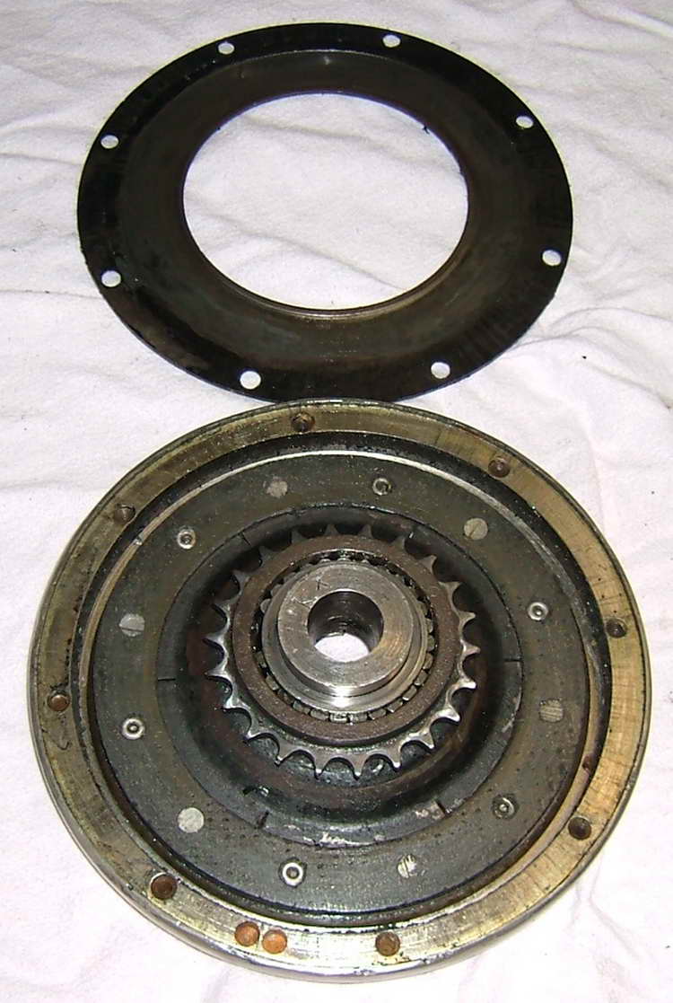

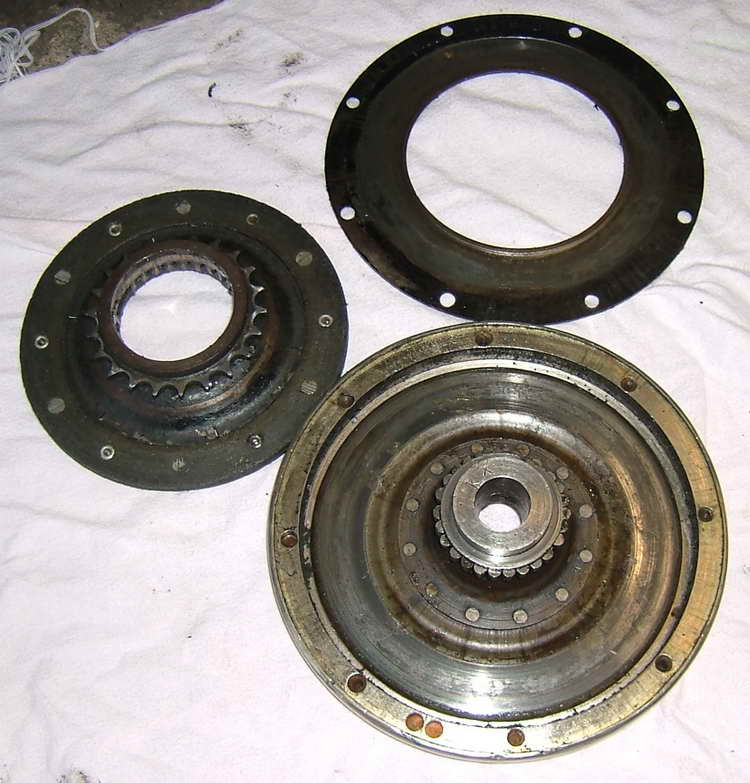

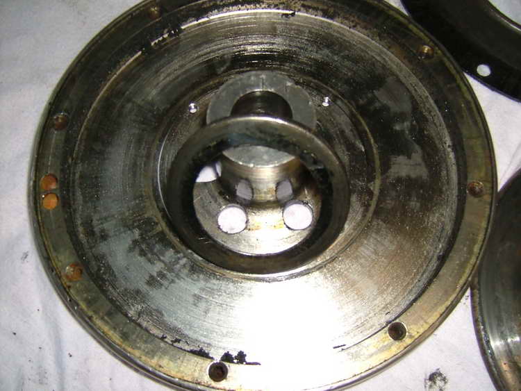

Barry,
     As Eddie said some clutches run direct on the operating cam as does mine.
Prior to the Banbury Run 22/06 I dismantled and cleaned the clutch on my EW.
I took a series of photos as I dismantled it (not taking any chances, as I'm not a trained mechanic), I have posted them hoping they may be of some assistance.
Keep going, we are with you all the way. Roy.

Barrie's EW running at last, It was a real blast when it fired actually scared the H--l out of me I was really looking to see if the clutch was going to slip or not gave it a bit of a kick and away it went. The biggest problem was that the clutch pressure plate was hanging up on the flywheel boss and not allowing the pressure of the springs to clamp the friction plate. the partially slipping clutch not allowing the engine crank properly. The other curly one was the Maggy advance leaver is set up backward so when you advance the leaver up top it retards the ignition, They don't start well with the ignition after TDC.
