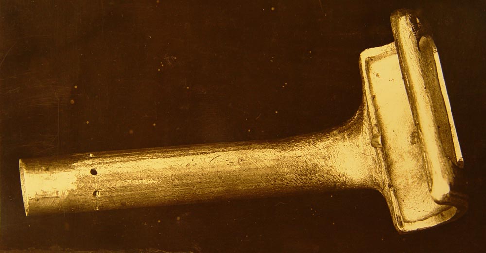

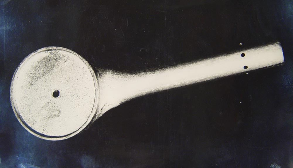

Ian,

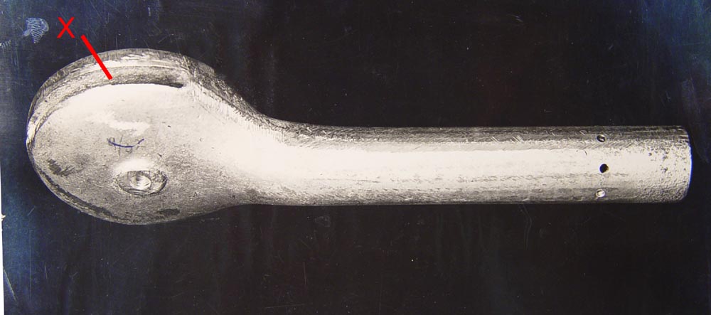

Here is a 1926 catalog image of a carb inlet heater, which Douglas called the "Special fuel economy heating pipe". I am sure this is the one Chris calls the "banjo".
Larger view
Also some pictures of the machined but as yet rough castings. Note the air inlet seems to be a slot on the front face, marked X. There is no communication to the rear face, which is just a heat transfer surface.
Larger view
Larger view

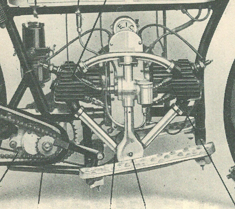

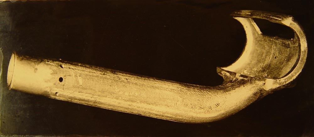

A second style is shown below, I think the second type mentoned by Chris. I do not recall a catalog illustration showing this type myself, but it would seem to be for exhaust systems where you do not have the central silencer can directly under the engine, rather a pipe(s) heading to the rear of the bike where it may, or may not, enter a silencer. In this example I would think that (again a rough casting) needs additional machining, to punch a hole or two from the portion that wraps around the pipe into the cored passage leading to the carb. Though why it is not already cast in, it would have helped support the existing core, I have no idea.
Larger view
Larger view
I have only seen pictures of these, if I ever saw an actual one, it has escaped my memory.

Thanks Doug for finding the illustrations and posting them. The wrap around type does have a full bore hole from the wrapping section straight up to the carb. It also has a hole for a screw and there is a shaped clamp secured by the screw and a nut so that the assembly is clamped around the exhaust pipe.

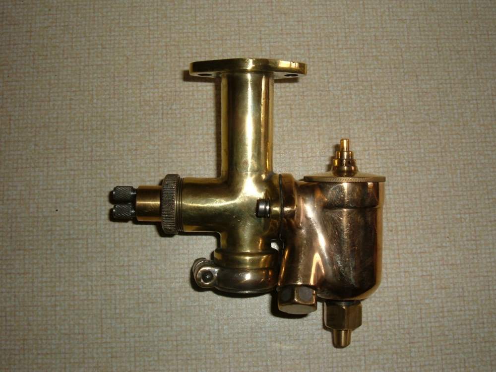

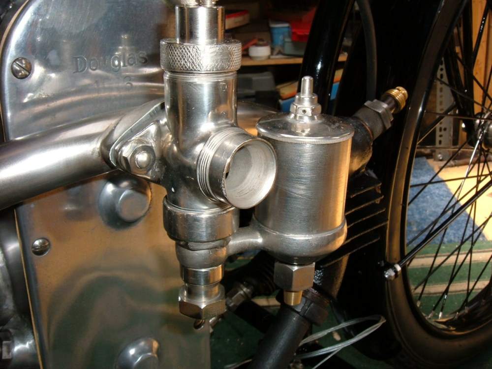

Chris kindly provided these photos of the two brass AMAC style carbys that were available.
Larger view
Larger view
gsx1100s
I was searching the forums for advice on my Amac carbie. I have found that my carbie must be an early model one as it doesn't seem to fit the bill anywhere. the picture above is the closest to it ( the silver carbie). My carbie is brass and is bolted to the manifold on the side not underneath . it also has two cylindrical projections from under and either side of the air intake. Any suggestions at to what these are ? And are there any detailed drawings of this carbie I may be able to find ? I would like to know whats missing from mine.
Thanks in advance,
Michael
"My first car was a motorcycle"
Ian
Michael, it may be a double skin one where it can have hot air takeoff from the exhaust system which keeps things warm - the projections would be an inlet and outlet for the warm air. The exhaust system would have a place where you can attach a pipe for this. If you have a look at the closeup photos of Kevins 1920 Model W on the photo identification pages you will see what I mean.
