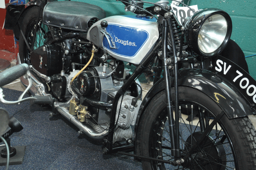

The LDMCC sez someplace there the tartan was introduced for 1931, when the T6 and the S6 became  the Models D and E ?
This bike seems to agree with your pic at the back left.
Can't help with the pointy vs rounded end ...
