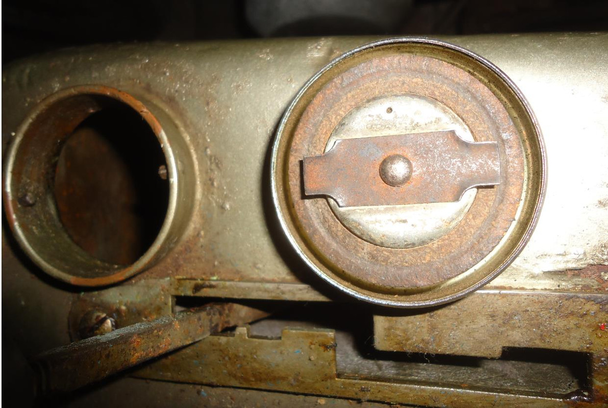

So, the EW 350 project has stalled over the petrol and oil tank caps.
I've never seen what these look like, and have been thus far unsuccessful in tracking any down.
I've read the advice about buying Austin 7 ones, and "modifying them".
But modifying them to what  ??
My tank has 2 little lugs per fitting, so what does the underside of the cap look like ??
This is what I have at present, but clearly it lacks/needs something.
This cap also is chromed, and it should be nickel ??
Do other duggies (douglassi ?) use the same cap ?
Any pointers greatly appreciated, pics would be marvellous...

Hi tank neck looks the same as on my aero will post a couple of pics later

« Reply #2 on: 12 Mar 2020 at 14:29 »
pics attached

Thanks Taz, thats excellent.
They look ordinary enough, wonder why I haven't come across any...

Hi
Regarding  Austin 7 oil filler caps.
 If you go to theaustin7workshop.com look under pares part number Eoo83 (note their are two different caps the one that fits is marked coil) there are pictures.
I have fit two of these to my EW the petrol cap requires an air hole drilling.
The butterfly underneath does not extend far enough out to catch on the pins. I removed the old pins which were rivited to the tube made new brass pins tapped m3 and secured them with m3 c.s brass screws. I then drilled and tapped the butterflys to take the chains,where to fix the other end of the chain as yet to be resolved, fixing to the filler tube it catchs the cap.
The caps I purchased are brass from another supplier a7.coukspares.
Hope this helps

Hi all after seeing this post here is a photo of the two filler caps I have made.They are made from brass (nickle plated afterwards)and the spring is made from a piece of an old wind up gramophone spring.
