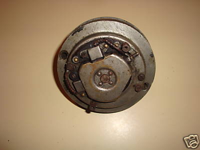

Is this douglas? - BTH Dynamo
Started by trevorp, 16 Jul 2009 at 09:58

see here

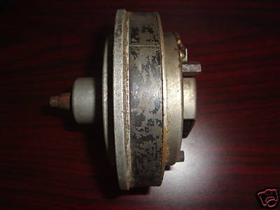

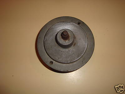

In good condition a generator of an early motorcycle Douglas? missing the back cap but apart from this looks v good.

Trevor,
             This looks like a BTH pancake dynamo as fitted to the Aero Douglases. It is very much like the dynamo fitted to the S6/T6 but with a longer drive shaft. It also appears to be a late version with the one piece magnet (earlier versions had 2 half circle magnets).
