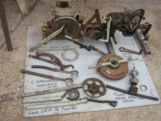

I've just had a shed session with the flywheel and have some questions.
Now that I have the 'dog eared washer' my flywheel parts should be complete but I still can't quite see how it works and am determined not to put the Douggie into the broken bikes pile because it is so close to being rideable and the summer is just around the corner.
When I put it together with the springs just giving a little pressure the clutch arm could not be pulled beyond a certain point as though everything was locked solid.
1) The pressed steel 'washer' which the clutch springs press against... Have I got it the right way around? (see photo)
2) The friction material is riveted on both sides to the plate. The total thickness is 0.35". Does this sound about right?
3) When the thrust washer is pressed against, the friction plate is almost at the end of its travel.
4) Any pointers would be most welcome. I can post additional photos if that would help.

Re: Clutch Setup (1926 EW)
« Reply #1 on: 16 May 2008 at 23:00 »
Hi Dave,
I measured mine a while ago, when someone asked a simalar question. I wrote at the time
"I just measured mine, which has only done a couple of hundred miles since it was relined. The total thickness is 8.5mm. That's 2mm of spring steel with 3.25mm of friction material on both sides."
That relates to 0.33" Pretty darn close.

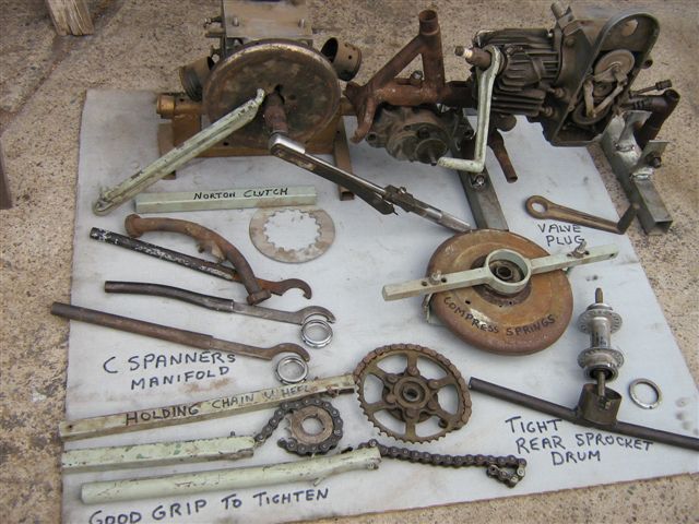

« Reply #2 on: 17 May 2008 at 13:03 »
Thanks for the replies thst I received both on and off forum.
Looking at the way the friction plate is moving away from the plain plate it seems that there is very little movement or room for it to get away from the plain plate and I wonder if this is the problem? In short I think that there is nowhere for the friction plate to go when its all bolted up.
Here are a couple more photos which show the actuation components.
« Reply #3 on: 18 May 2008 at 06:13 »
Dave,
The cup washer goes the other way, cup facing the springs. It does not allow the pressure plate to move that much further, but it does stop the washer from bottoming on the radius of the hub on the flywheel. The rim stops the coil springs from flying out under centrifugal force, and perhaps binding in the holes where they pass through the flywheel.
There is not a lot of clearance for the clutch disk. With the springs removed and the cup washer right way around, you can test the position of the pressure plate in what would be the fully released condition. It can go no further. Set the clutch disk on the pressure plate, and measure how much clearance you have to the rabbet where the backing plate seats. In this used EW example, there is 3/32" clearance (see image below.) Probably you would want no less than 1/16” when the linings are new; else the clutch might not release enough to free the disk. It would not need much if the disk stayed true, but it likely wobbles and rattles about a bit in there, so it needs all the clearance it can get.
Also, make sure your pressure plate drive dog washer is inboard of the cup washer.
