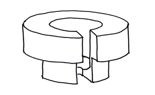

Tomasz,
While I do not have one of these in hand to measure exactly, I have examined one.
The diameter of the collar is the same as the tube it sits upon. It is smooth on the outside (no knurl). It has a spigot that fits down into the inner diameter of the tube. It is a loose fit, no need for fine tolerances. The spigot is short, only about 1/8 inch long. The thickness of the collar is about 1/8 inch also. It is - of course - drilled coaxially for the Bowden cable. There is also a counter bore for the cable casing ferrule. Deep as practical but not critical as it can be compensated with the cable adjustment. The last feature is an axial slot to allow it to be slipped over the inner cable.
