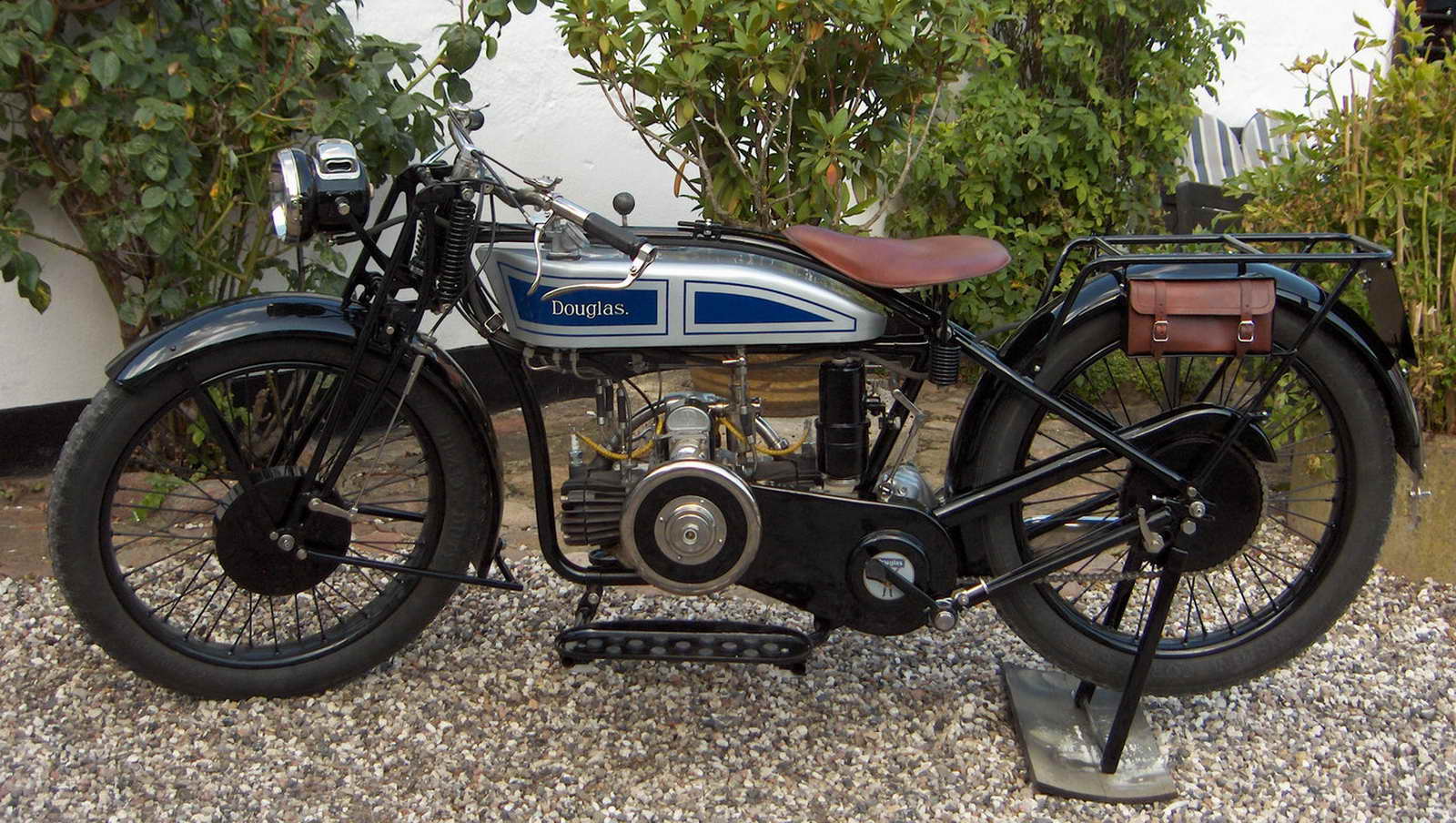

Enclosed foto show a 1926 EW,- just about what you try to buy
Regards and good luck
Edin DK

The EW 350ccm 1925-26 bike,- are not special rare,- but exelent to ride,- and reliable.
The price 2K,- is twofold the price from around here,- for an EW in that condition.
The EW bike from the picture in my first answer to you, have been sold 2 monts ago,- for a price of 8000,£
You are welcome to contakt me direct on email about restoring (easy english please)
Regards and good luck Edin DK
