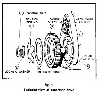

Alwyn,
Yes the gear case should be packed with grease; stiff wheel bearing grease was recommended. Nor was there any adjustment for the spring pre-load, it was fixed by the design at the factory. It is there to prevent inertial overload of the drive to the dyno, due to a rapid acceleration of the engine (which would be multiplied by the gear ratio.)
The finger spring should bear on a large steel washer, which in turn bears on the face of the fiber gear. Omission of the washer would reduce the spring pressure slightly and probably cut grooves in the face of the fiber gear. Also any washers behind the center of the spring that would stop it from fully seating on the hub would reduce the spring pressure. The hub that the fiber washer can slip on, is itself keyed to the magneto armature shaft (two small woodruff keys if I remember correctly.) If these were omitted, it may not be the clutch that is prematurely slipping, but the entire hub spinning on the armature.
Finally the dyno pinion itself should be keyed securely to the dyno armature.

I dismantled the magdyno drive 'clutch' yesterday. Similarly to your mate's experience, I found that the contact face (flange) of the fibre gear that bears (under pressure of the tension spring) upon the the 'Gear Centre', is worn (or more appropriately described, burnt!) to the extent that just a thin layer, maybe a millimetre thick, of compressed but crumbly grease impregnated carbon residue remained of it beneath the 'Pressure Ring". The latter is scored too, a significant channel of a width consistent with the tips of the 'fingers' of the 'Tension Spring', is quite visible and I suspect too that there has been sufficient heat generated to anneal the spring.
I have secured the replacement parts and expect delivery from Sydney within a day or two. But I still have a significant problem to resolve! That is to grease or not to grease the mechanism by packing the case? I note your comment about the seal - I'm intent on renewing it and had noted the direction of it upon dismantling - but more to my point, you say in respect of the seal that it's not meant to "...keep the grease in". By this I think you intimate that the case should be packed with grease upon assembly.  Contrary to this, I have been advised by two magneto repairers (both of whom claim 40 years of experience in their trade) that the drive is/was designed to run dry and any oil or grease introduced within the case will cause the drive to fail!
The Lucas literature kindly provided to me by Doug is silent upon the matter of lubrication. Can you advise further on this question please Eddie?

PS.
It may assist those interested and who are unfamiliar with the mechanism as I was before this incident, if I attach a cut away illustration of the drive taken from the Lucas instruction book, so here it is....
