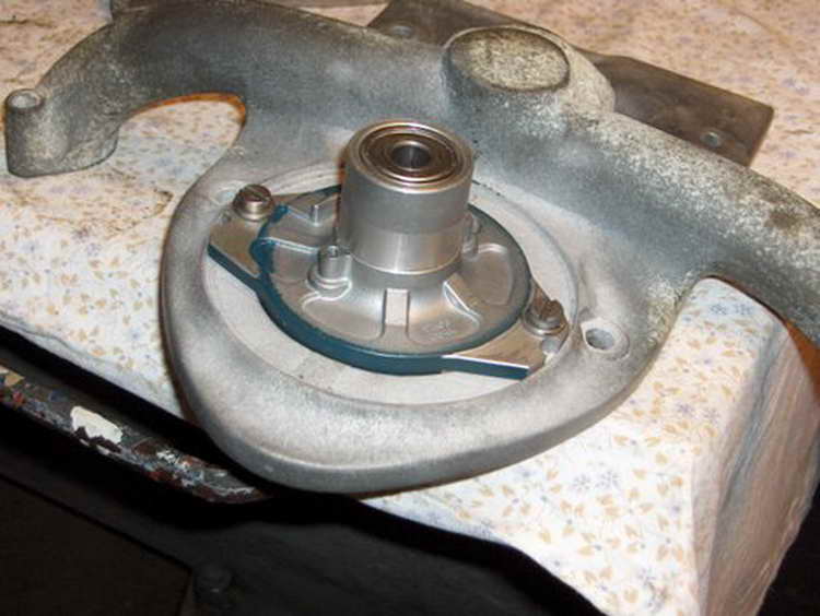

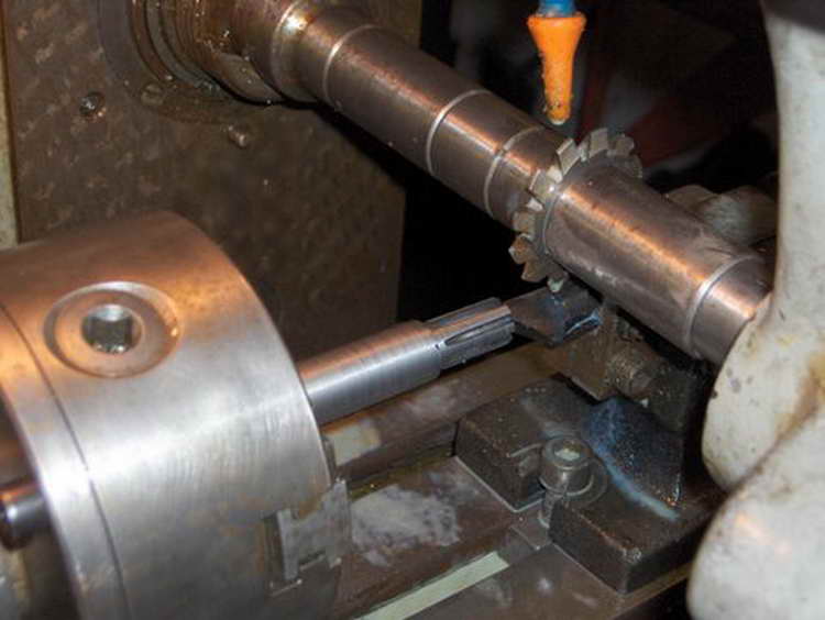

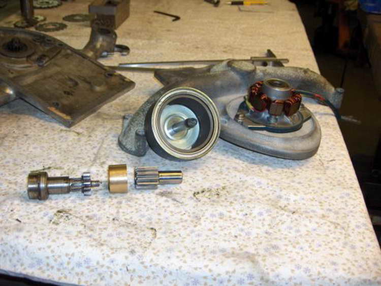

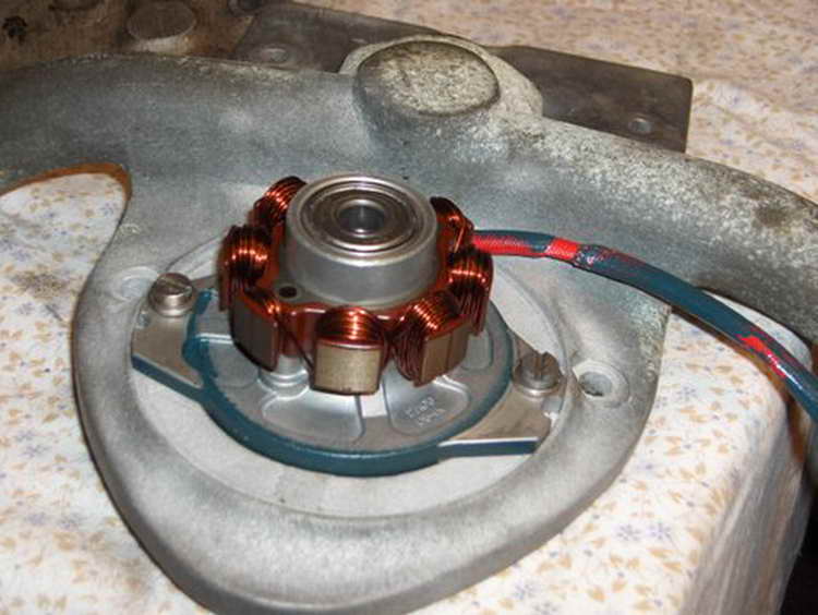

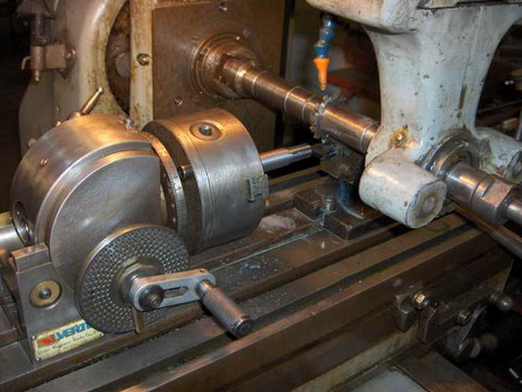

He all
Thanks for great interest,- help and support with my project to build an alternator on my 1930 - T6.
The job is done,- the test is finish and the result is good. The test outcome was following : 14volt - 10amp - at 2000 rev./min. The alternator I build on, came from a small KUBOTA dieselengine.
The price for the alternator is doubtful - "a small part in an bigger deal" - about £150,- and to this I have to add
a SPARX  regulator rectifier at £30,- + Vat and shippingcost from UK.
As illustration to the job enclosed a fotoserie there step by step shows you what is done.
regards Edin DK.
[edit image links from http to https, Doug, Site Moderator, 04Dec18]
« Last Edit: 04 Dec 2018 at 21:51 by Doug »
